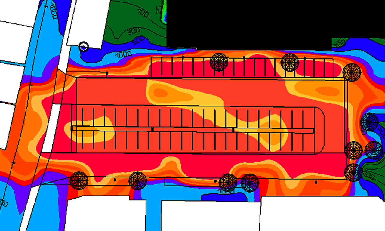

With the DIALux evo 13 version, we support you in the evaluation of obtrusive light sources, light immission and glare. Without much effort, you can calculate the variables
- Luminous intensity I[cd]
- Illuminance E [lx]
- Glare rate RG
- luminous flux ratios Ruf, Rul, Rulo, Rdlo
- and the proportionality factor Ks
for incident light scenes as a new value, i.e. with a maintenance factor of 1.

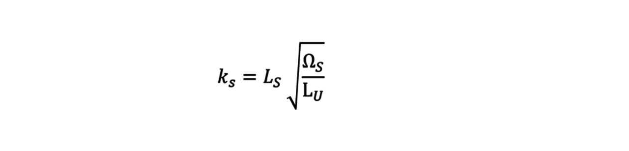

The glare rate ks is defined as follows:
- LS: Luminance of the light source (in candela per square meter, cd/m²).
- ΩS: Solid angle of the light source (in steradian, sr), i.e. how large the light source appears from the viewer's perspective.
- LU: Luminance of the surroundings (also in candela per square meter).
The glare value shows how bright the light source appears in comparison to its surroundings. The higher the value, the more disturbing the light source is perceived.
